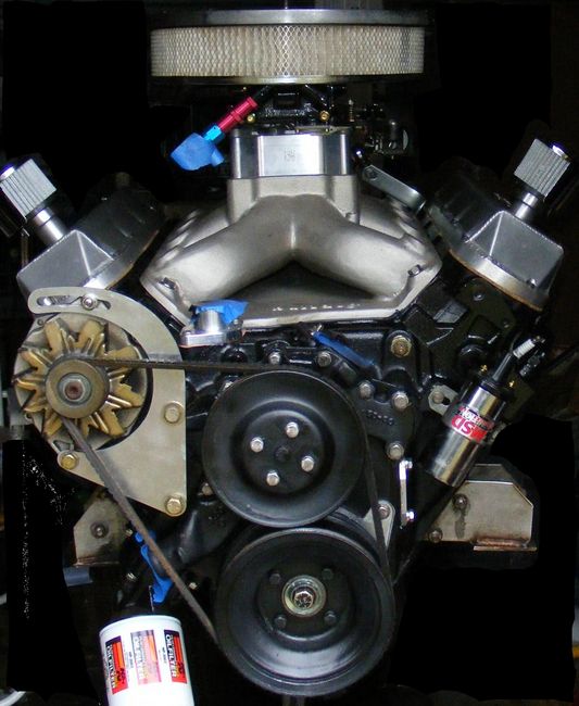

1974 Cadillac 472 Block bored 30 over and O-ringed
793 Crank turned 10 mains & 10 rods, balanced by Mr. Potter to my pistons & rods
Ross Forged 30 over 10:1 pistons fly cut for larger valves
Scat Forged Rods
Potter Stud Full Main Bearing Girdle Windage Tray and Crank Scraper & Custom Rear Sump Pan
950 76cc Cast Iron Heads Ported by Potter and T&G Automotive Intake flow 325cfm and exhaust was ? can't remember
5 angle valve job by T&G Automotive with dual springs for the big stick
2.19 Stainless Intake Valves & 1.79 Exhaust Valves Massaged by Jerry Potter
Potter Head Crossover Cooling Kit
Copper Head Gaskets
Hastings Rings
Clevite Main Bearings
Clevite Cam Bearings
Potter Cam Button
Potter Shaft Roller Rockers
Custom Comp Solid Lift Cam .655 lift Intake and .650 Exhaust, Duration at .050 is 264 Intake & Exhaust Lobe Seperation is 108.0
Trick Comp solid lifters with a .012" oil hole
Bulldog Dominator Aluminum Iron Head Intake with Epoxy added by Potter(Nice Job), and milled by Jerry to fit the block
Bushed Lifter bores by Jerry Potter
Cloyes True Roller Chain & Gear
New Melling Oil Pump & NAPA Gold Filter
2 Gallons DELO Oil
New Water Pump
Potter Aluminum Timing Tab and Alternator Bracket
Billet Pulley Set, Distributor Hold Down & Water Neck(Prototype Engineering)
Potter Aluminum Valve Covers & K&N Breathers
MSD Cadillac Distrubutor #8363
MSD 7AL-2 Ignition
MSD Blaster 2 Coil
Taylor 8mm Wires
Autolite Plugs
Alloyblotz Stainless Engine Hex Bolt Kit
Maddog SFI Flexplate
ARP Head Studs
Mike Cookes Headers(What a jumble of tubes) Ceramic Coated
Holley 1050 Dominator(Massaged by Stan the Carb Man)
Griffin 2 Row Aluminum 1.5" tube Radiator with Griffin Aluminum Shroud & Fan(Rated to 800HP)
K&N Dominator Air Cleaner
RobbMc 110 Fuel Pump
RobbMc Mini Starter
RobbMc 100 Micron Fuel Filter
Potter Custom Fuel Lines
K&N Fuel Filters
1984 Buick Regal(Turd Brown for now) New Paint comming soon, Stock Interior
Weld Wheels & MT Drag Radials & Slicks on another set of wheels
Hurst Shifter
Ford 9" Rear fitted for a G-body 3:89 Posi
Double Adjustable Tubular Lower Control Arms
Double Adjustable Upper Control Arms
Tubular Upper A-arms
Stock Cadillac TH400 with a shift kit
PTC 4000 stall converter
Driveshaft Safety Loop
Borla Stainless Mufflers (Side Exit Exhaust)
3 1/2" Cowl Fiberglass Hood (Bolt On)
Best Pass at I 40 Dragway Test & Tune 60' time 1.648 and time was 7.336 @ 96.343 MPH
Updated best pass 11/3/2007
RT 0.003  60' time 1.648  and ET was  7.247 @ 98.567
I added a 2" HVH Super Sucker and dropped the jets down to 95 primary & 96 secondary

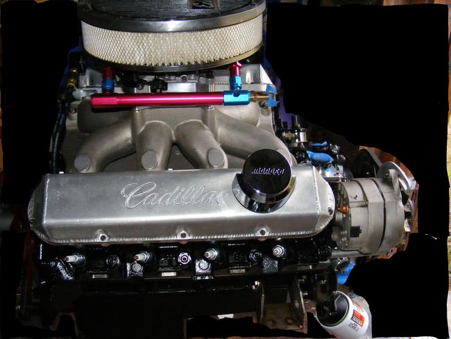

my latest airboat motor.
525 cid
stroked 4.42 crank with  2.2 pin
4.350 bore kb forge pistons with ceramic coat.  10.4-1  compression.
7.1 -k1-tech rods before mts started to carry them :cursing:
iron heads- big ss valves porting/polishing started by machine shop and finished by me(what a bitch) unshrouded a little
cam 588 lift single pattern
plasma moly rings
old puddied up bulldog(thanks smalltruckbigcid)
shaft rockers
850dp built by a company that i cant remember the name right now

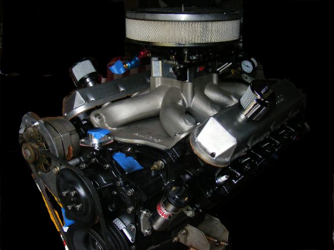

Car is not finished so no ET - hope is OK to post
Engine: 535 cid. 4.400 bore & 4.400 stroke
Manley 6.95" rods with Chrysler rod journals
Custom pistons with 8.8 to 1 compression.
Potter pan and girdle
Ported iron heads with 2.19 in and 1.84 ex  tripple springs with titanium retainers
7/16" pushrods.  T&D rocker system
cam is a Comp solid roller - .672 in lift and .660 ex lift    254* @.050 in and 262* @ .050 ex  on a 114 lsa  bushed lifter bores
Intake is a BDS 1071 blower with 2 900 cfm throttle boddies
Two inline FI fuel pumps to supply plenty of fuel
Was dyno'd with 2 different carbs (not the FI) and 5 lbs of boost near 800 HP and 735 TQ
Custom built (by me) coated headers  3" ceramic coated exhaust with Borla mufflers

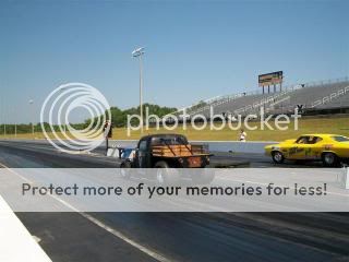

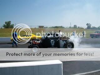

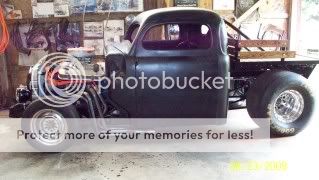

Hi all...since this picture was taken I have finished the truk, it now has windows and went to the track friday nite for test and tune.
It is a 51 Ford pickup cab chopped 4 inches, sittin on an 84 S10 frame that I back halfed using ladder bars and coil overs with a 9 in rear, 3.50 gear with spool and 31 spline ford axles. Wheels are Monoque with 16 x 33 goodyears from a swap meet, couldn't pass on the price. 500 caddy is .030 over with 353 KBs on 4130 I beam rods. 270H Comp cam Cloyes chain, chevy lifters 3/8 pushrods, I think they are 10.1?..Potters adjustable shaft rockers. Heads are 950s with 2.11 and 1.77 pontiac valves, 1.25 small block springs at 120 seat pressure. Little pocket porting to acomodate the valves. 2115 Edelbrock, no mods, 870 Holley street avenger. HEI dizzy , MSD coil, no vaccum advance, light advance springs gives it 20* at 2000 rpm for a total of 30* crankshaft. Headers are 1 7/8 tubes all about 45 inches long into 3.50 collector. Loud next to my ear drums. 350 turbo trans with race clutches and shift kit but still has modulator. May chang that.
Went to test and tune  and best ET is 8.09 1/8 mile and 12.50 at 1/4 mi. Seriuos bog at mid track, will work on that cuz I want at least 11 second 1/4 miles. ;)

  Ported 76cc heads with 2.19/1.88 valves
  Custom stud mounts with Crower 1.7 rockers
  Custom 10.200" length pushrods
  263 @ .050,.550 lift,112 lobe sep single pattern solid cam installed 5 deg advanced
  11:1 compression ratio
  Edelbrock 2115 intake lightly deburred and smoothed
  Stock crank polished std/std
  Stock Caddy rods resized w/ARP bolts
Stock aluminum oil pump w/ passages smoothed and radiused
  MSD distributor,Digital 6+ box,Blaster SS coil
  850 Holley DP
  Eldorado oil pan
  Corteco Head gaskets
  Cloyes timing set
   Makes somewhere around 550 HP
   Best 1/4 mile time 10.12 at 132 mph
  Best 1/8 mile time 6.43  at 107 mph
  60' - 1.455 sec.
This one?
It went 9.94 at 131 after I posted the list you quoted.Same engine and setup though.
Terry
