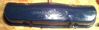

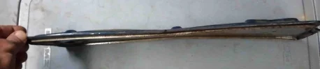

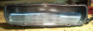

Hello all out there,
I am a newbie here, and if I'm here typing online and not in the garage then I know I'm stumped.
Have a 66 Cadillac 429, completely rebuilt (freshened up is all she needed) 60,000 mile engine (that had sat too long)
anyways
fired her up two weeks ago
perfect !
put about 300 mile on her since
daily checking hoses, belts, bolts, etc. all the usual stuff that might need attention after a rebuild.
gettin cooler here in PA
went out to start her up last Wed and she wouldn't fire, right away
pumped it a few more times
then
B A N G
backfire - through the crankcase no less
smoke cleared
I calmed down
opened the hood, discovered the choke face plate was loose and choke out of adjustment (cold out, primary flapper open)
adjusted choke
turned the key
she fired right up
what I didnt notice before I closed the hood which caused lots of smoke after about 2 miles out was that the crankcase backfire blew the valve covers open between the bolts (both banks, top and bottom about an inch from face of heads) and also blew the valley cover pan open (also about an inch)
I am at a loss as to how this backfire got to the crankcase

Holy cow!! The back fire literally bent the valley cover and both valve covers? Wow!

I sure would replace that fuel pump; I'm sure this is what caused your problem.

Actually had a spare set of Valve Covers for a 64' (don't have the dimples the 66' does)
After I found those, went down to the wood shop and made some forms for staightening the 66' VC's
Not too bad, actually now straighter than the 64's
