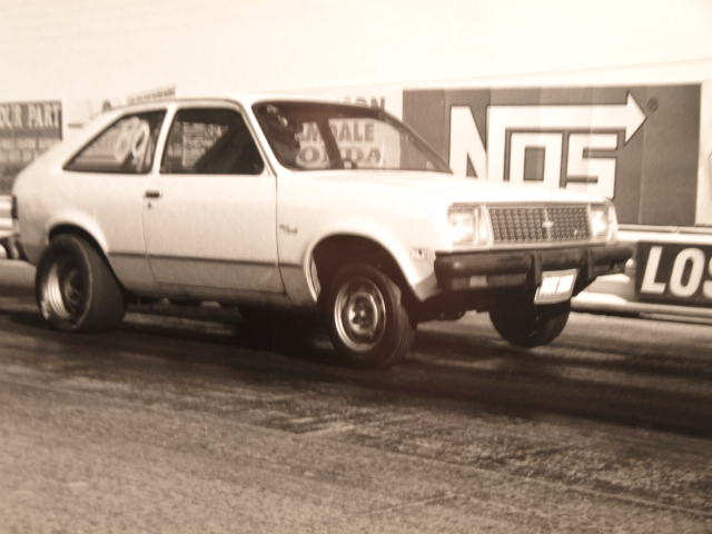

6. Hot Rod's 500 Chevette series. Someone help me out with that one, or others.
